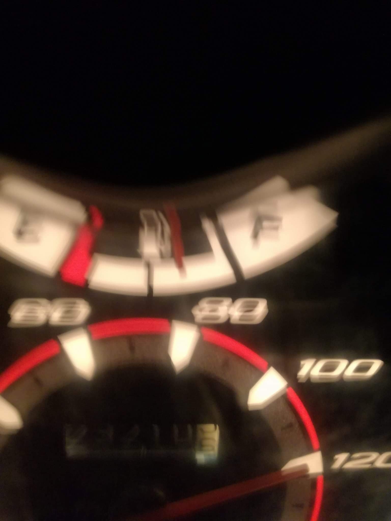

Re: Vision NSC 110 Tuning
Hi guys, Not a lot of parts available for the vision 110 wich is a bit sad but there is parts!
Have the same bike now for years and i was also searching to make it a litle bit faster,
What i have done is buying a takegawa variator (have a malossi too wich is also good!) and a takegawa ficon-2 whit takegawa silent oval muffer, did the ristrictor of the airbox and thats it.. It drive from stock (90--95km/h) to 110--120km/h on speedo.. So i think a good 100--110km/h on gps.. Onley sad thing is that you have to buy the parts from japan. (japanwebike) wich is a bit expensive..
There is also a takegawa 130cc high pressure available, i saw a video of the performance and i am under impression
that gonna be the next step i think..
