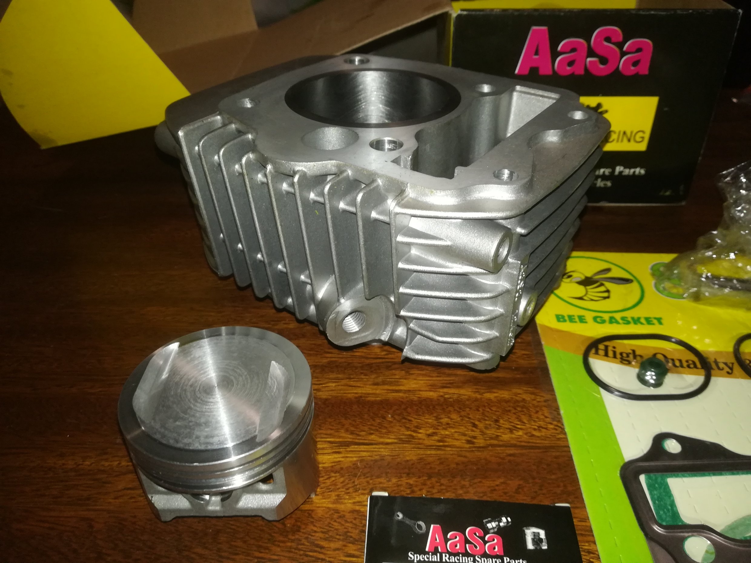

Hello,
Someone got Experience whit a fi controller like the takegawa ficon2 or other controllers?
We just put a 148cc aasa on the innova of my brother but it seems like the PGMFI needs to inject more fuel... The spark is too much white i think..
Grtz nic

The common way to solve that problem is to fit a higher capacity injector Which will inject a larger fuel quantity at the same pulse width from the controller.
Where did you get a big bore cylinder for the injection model?

Hi, yes i now about the injector but i saw someone saying on a forum that it was not good.. That it give too much fuel.. But i now there are different injectors 4 holes 6 and 8? But wich do we need?
The cylinder came frome mototrade.gr greece, good trustabel site and good parts like AASA and FAITO for good price..
