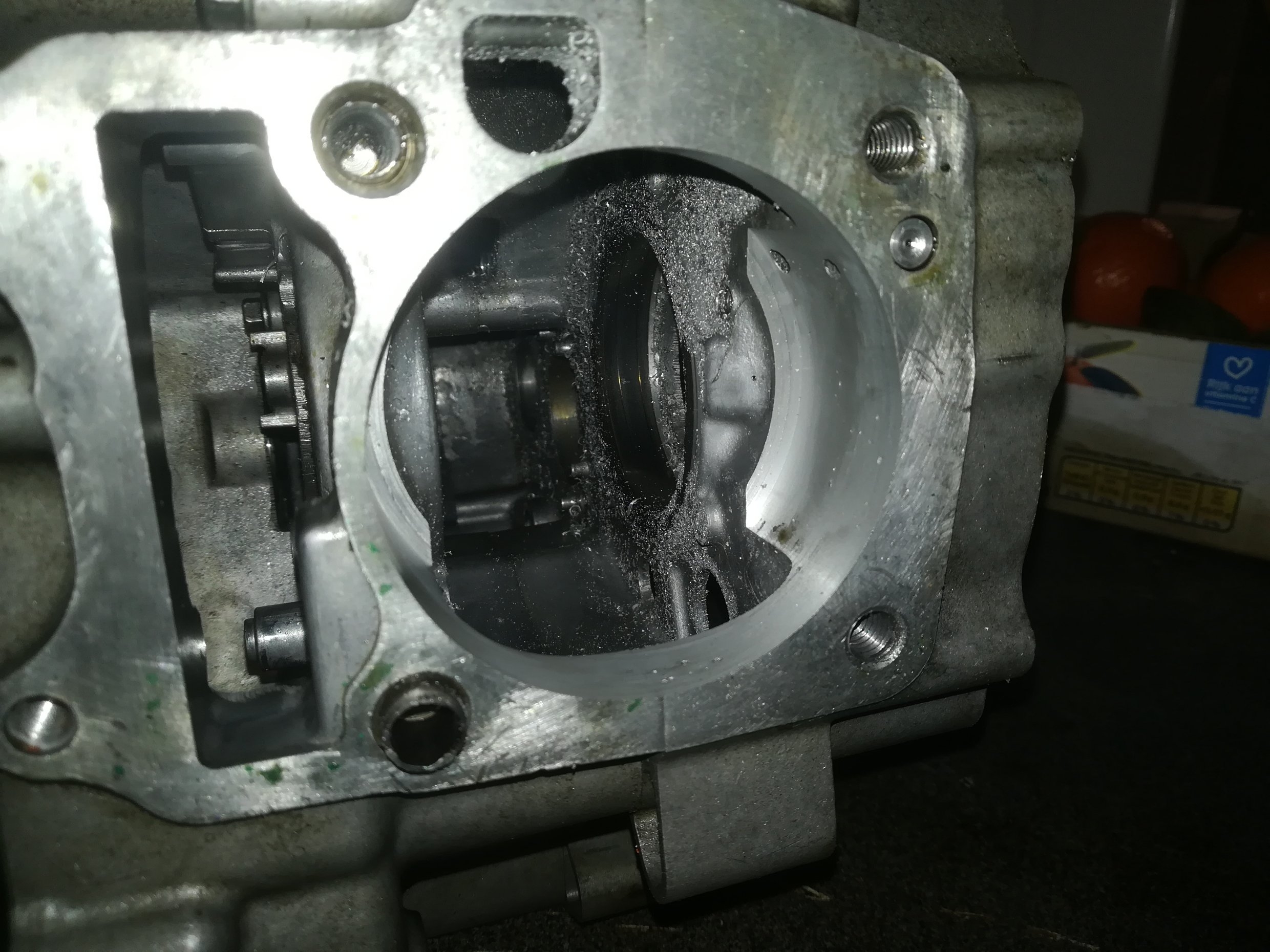

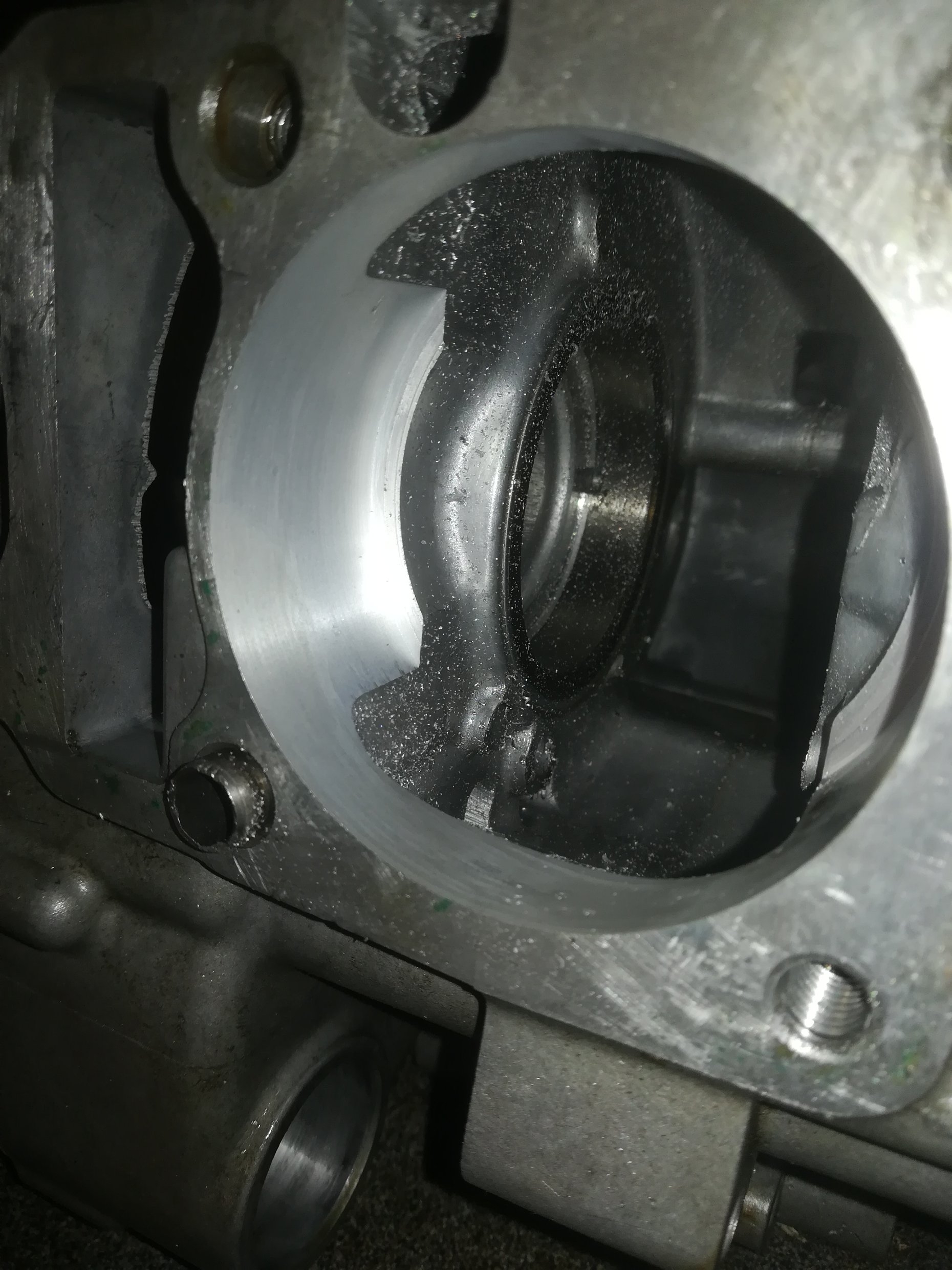

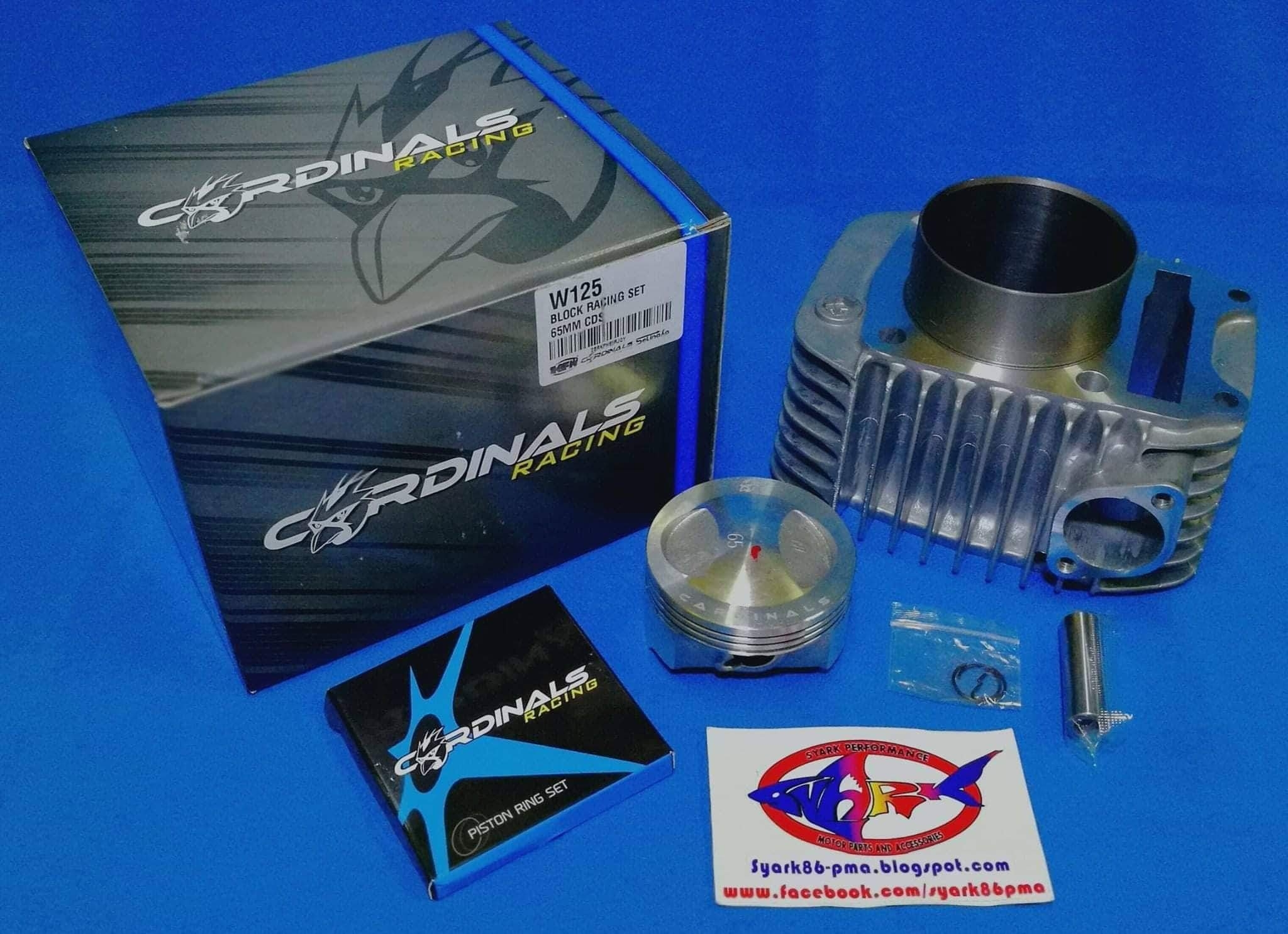

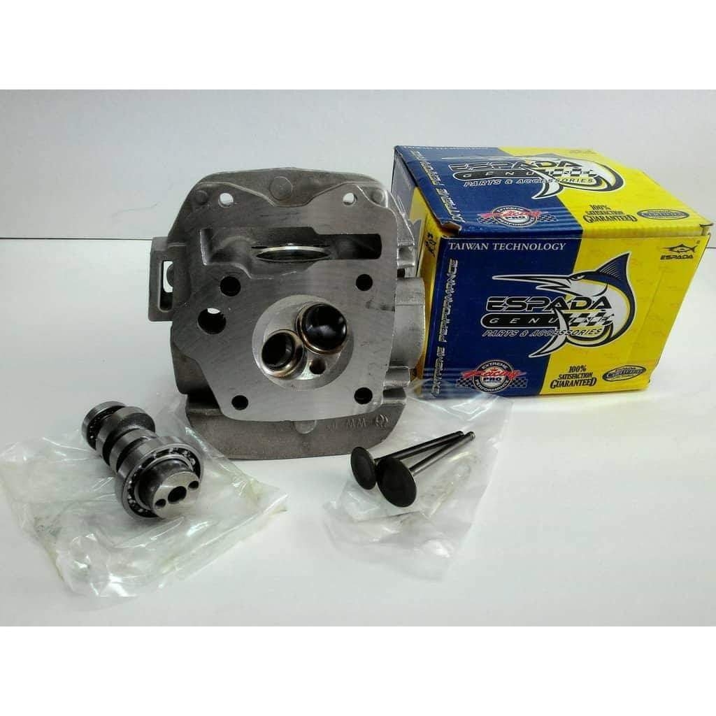

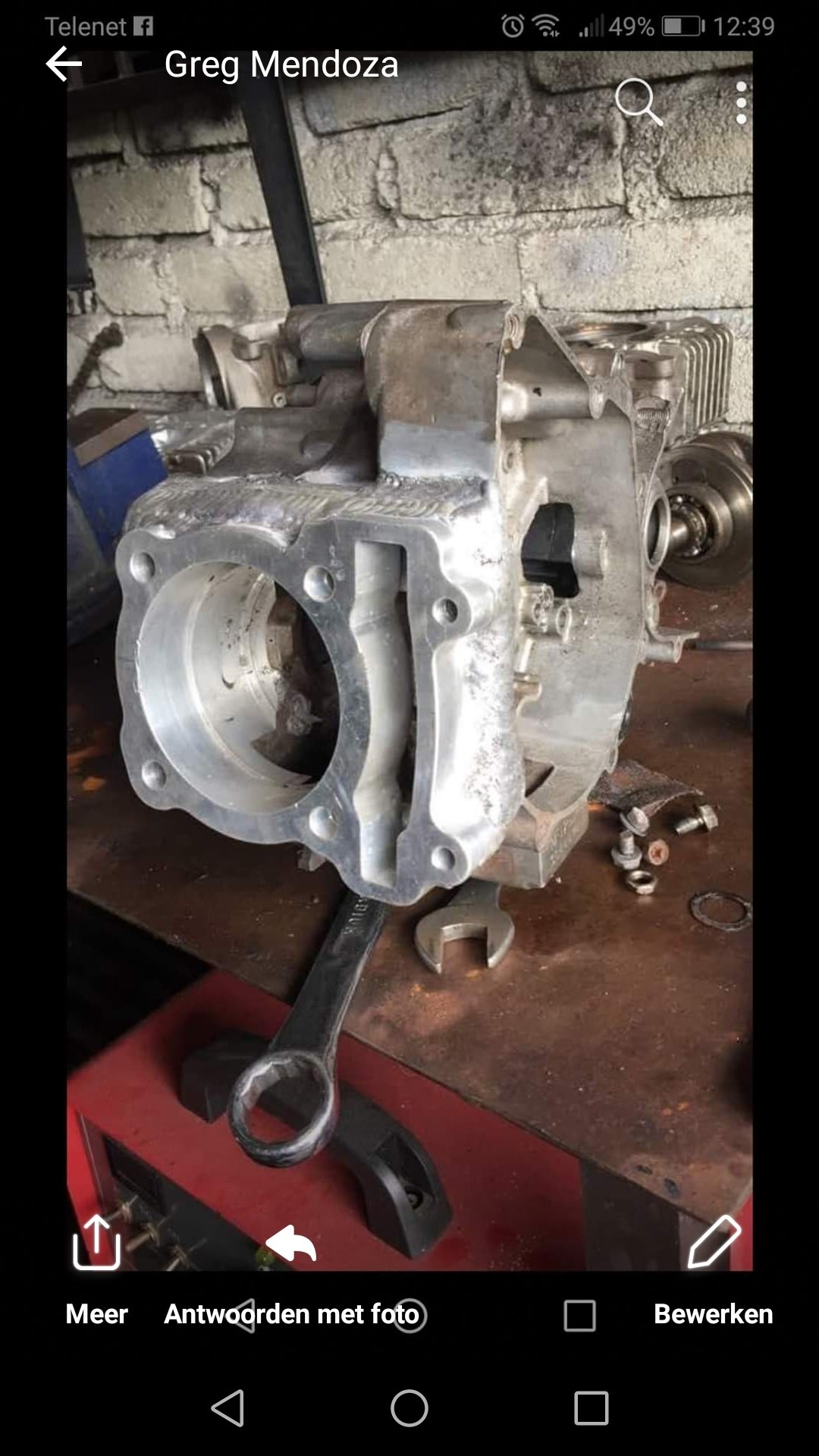

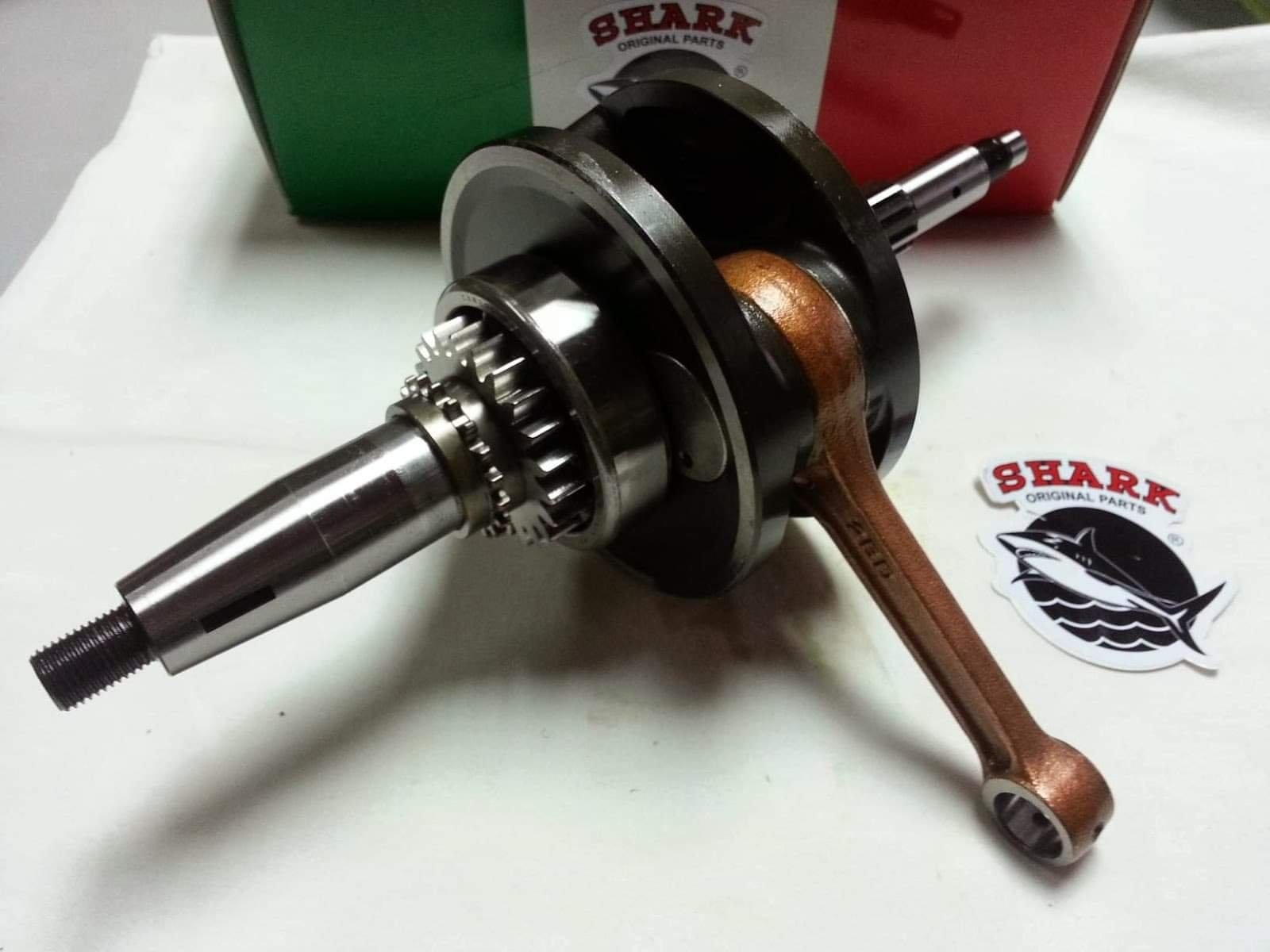

So i guess it wil be 210cc,
The Preparations is already started
Cases bored out 68.5mm to fit 65mm or later 66mm
Stil waiting for the gearbox parts from honda.. (shifters bearings, gears etc) i let the gearbox stock that will be the strongest..
Kit would be 65mm cardinals racing
Shark +3mm crank
Espada vavle head 27/31
Faito s4 evo cam
Carburator 30---32mm
Shark +3mm crank
Faito s4 evo cam

Re: Innova 210cc?? stroker
Hallo
auf dem ersten bild ist eine ölbohrung zu sehen . war diese vorher auch schon offen oder wurde sie
durch das aufbohren des motorgehäuses offen gelegt ?
Bastlwastl hat geschrieben: ↑Fr 4. Jan 2019, 13:22Hallo

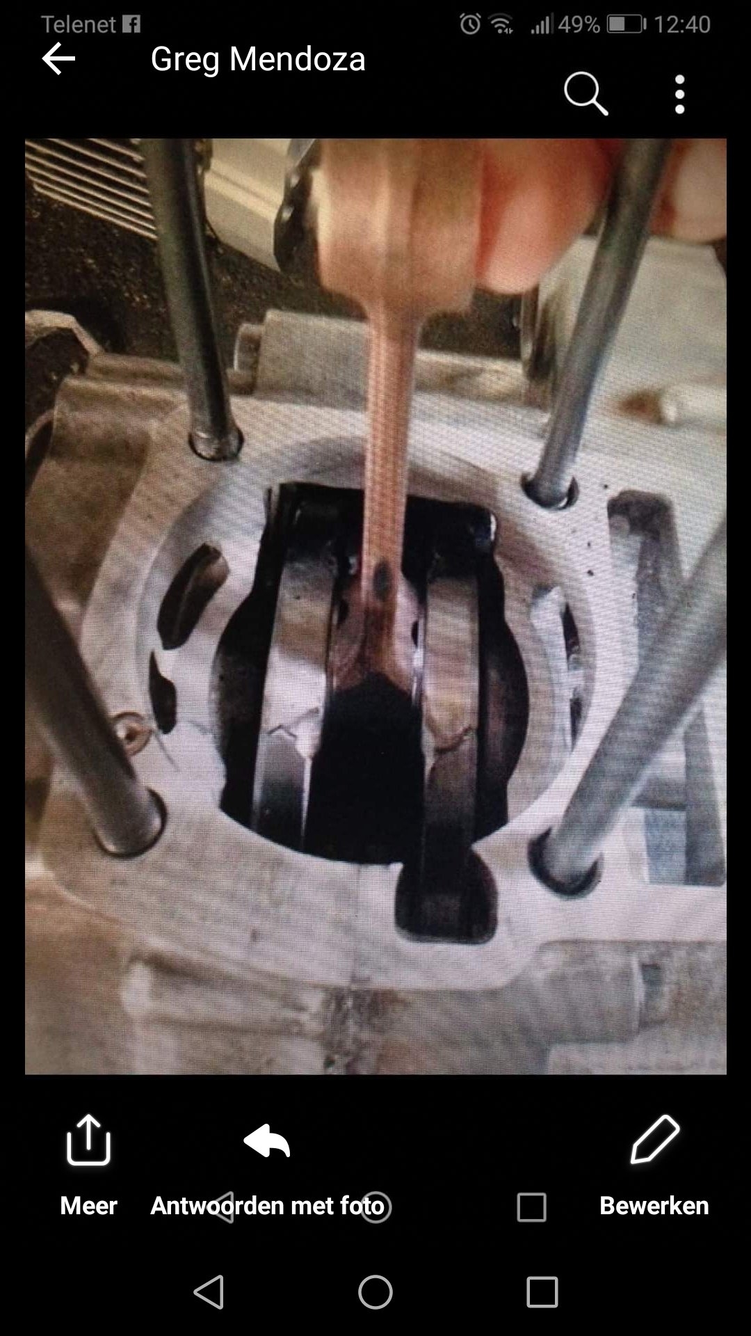

Thats normal by 68.5mm.. The oil sprayer is around 1.5cm under bore.. So it dont touch the pump or sprayer etc.. Someone i now is busy with a kit around 300cc, look
@ this holes
das Gehäuse wurde gefährlich weit aufgespindelt.
Für mich wäre das eindeutig zu viel des guten. Ob das alles der Leistungssteigerung standhält bezweifle ich
Das bricht so sicher wie das Amen in der Kirche Karl
Interessant wirds bei den 300ccm seines Kollegen...
Dont worry.. If everything is stronger it will not exploid
crank, conrod etc is a lot stronger than the stock one. but yeah, Fact is a stock innova will last longer for sure.. I have 3 engine's now.. If one breaks down i put a other on it and repair the other.. Parts are not that expensive in greece or Thailand.. So a lot of fun for the money. In the Philippines or Thailand they all drive with simular kit like that.. Even with more then 210cc.. Here in europe most people are scared to do thinks like that wich is sad
I have now a 5000km with the kit now.. Which give around 18--20hp It stil runs.. On the stock internals
This is the +-300cc engine from a guy here in begium.. Hi is now bussy on it
