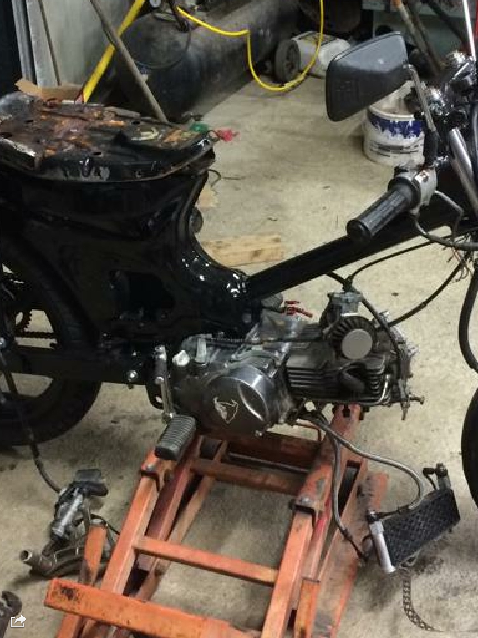

hello this is my first post on the forum pleas move if required..
Ok hear is my problem I have got a innova 125 engine I am fitting in to a Honda cub 90 .
All I got wast the engine and carb I have it fitted in the cub after sum cutting and welding .
My issu is I need to wire it but I only have a cub 90 wiring loom I got a 4 pin cdi any hel or info welcome ..
Could sum one post sum pictures of the wires and where they go ..

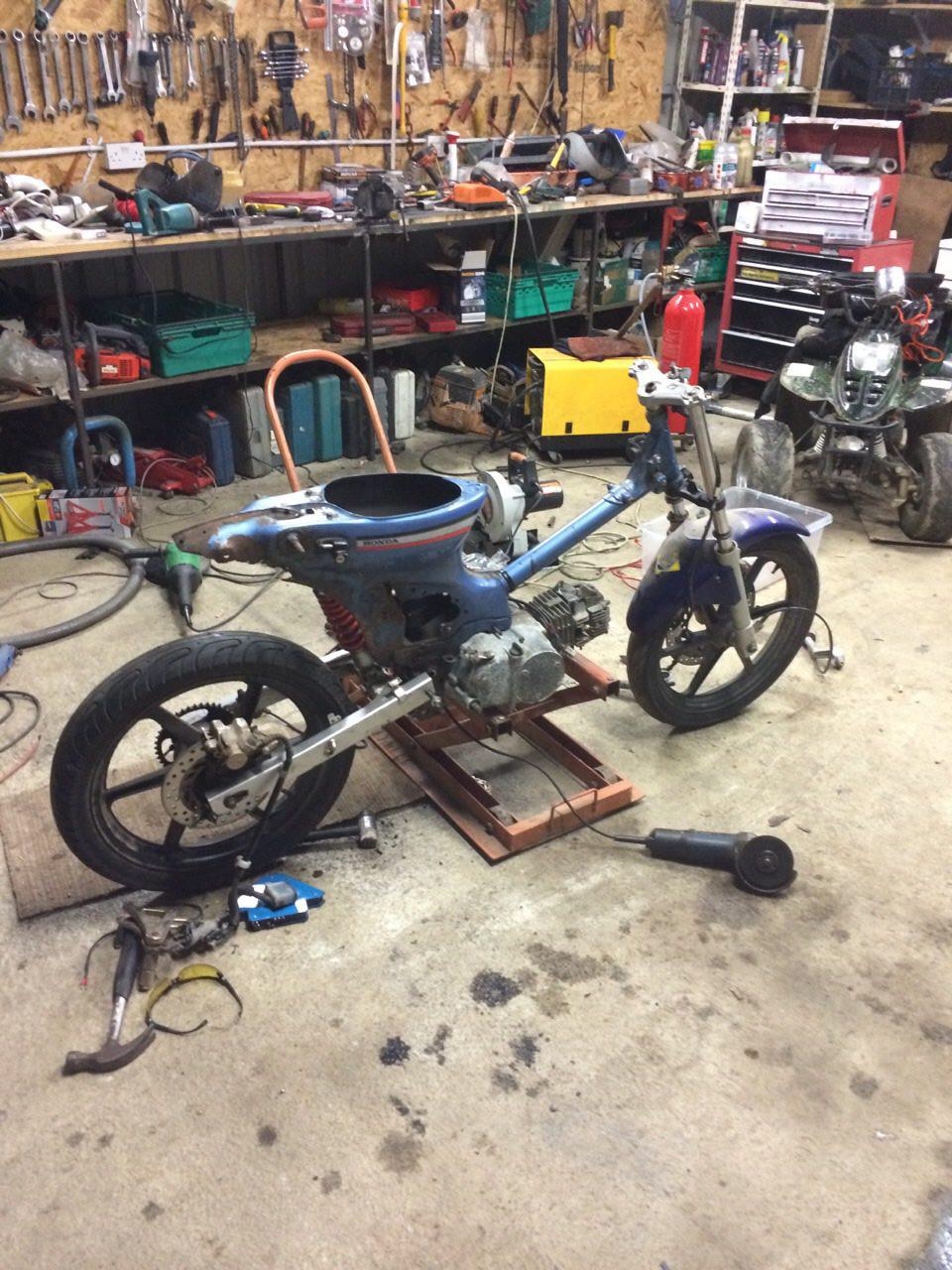

My project is for fun it is a Honda cub 90 Honda cbr swing arm and cbr 125 front end ..
Honda innova 125 engin .. I had a wave 100 in it but I wanted a bit more speed I also had a stomp 160yx fitted wit 2v head and big bore kit up to 184cc it was fun but gear box could not take it ..
You see my buddy has a Honda c70 wit a Honda cbr125 engin fitted my goal is to get the innova engin to go as fast as the cbr 125 if possible

Beitrag von Cookey »
Few pictures

Has any one got a wiring diagram for a innova not injection model
