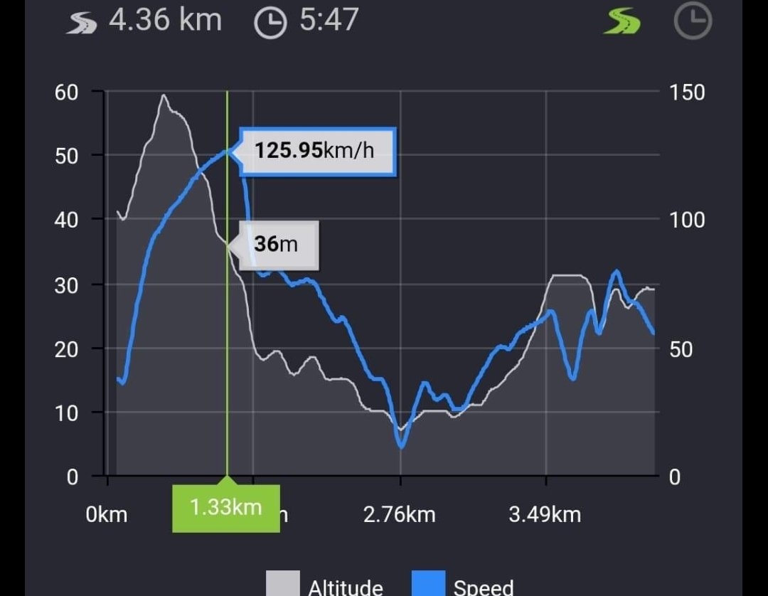

Maximum now is 125.95km/h on GPS thats about a 140km/h + on a innova dachboard/counter.. 🙃

Not Bad...
means she runs about 100km/h in Daily use...
