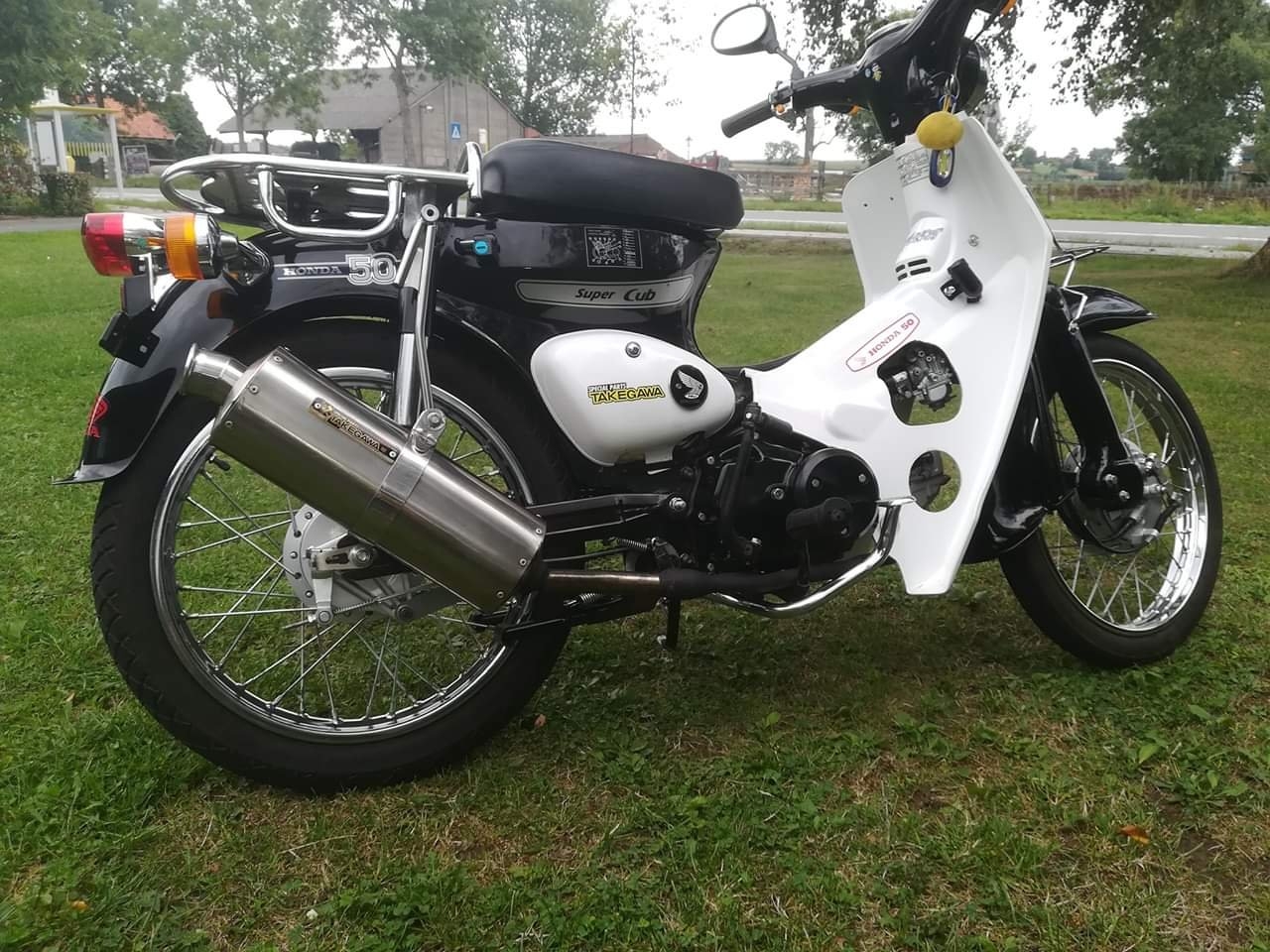

Ok, now my bike's.

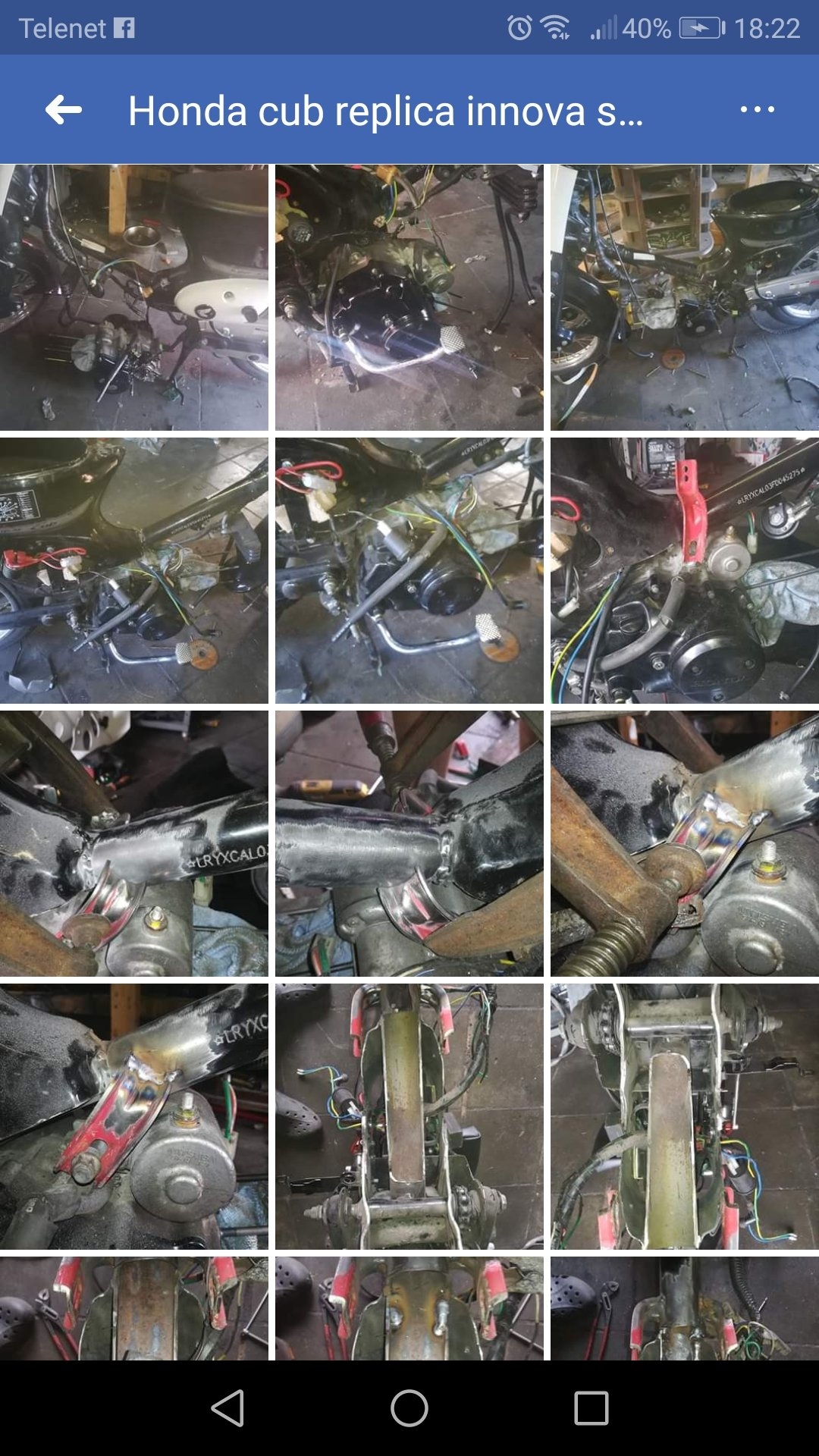

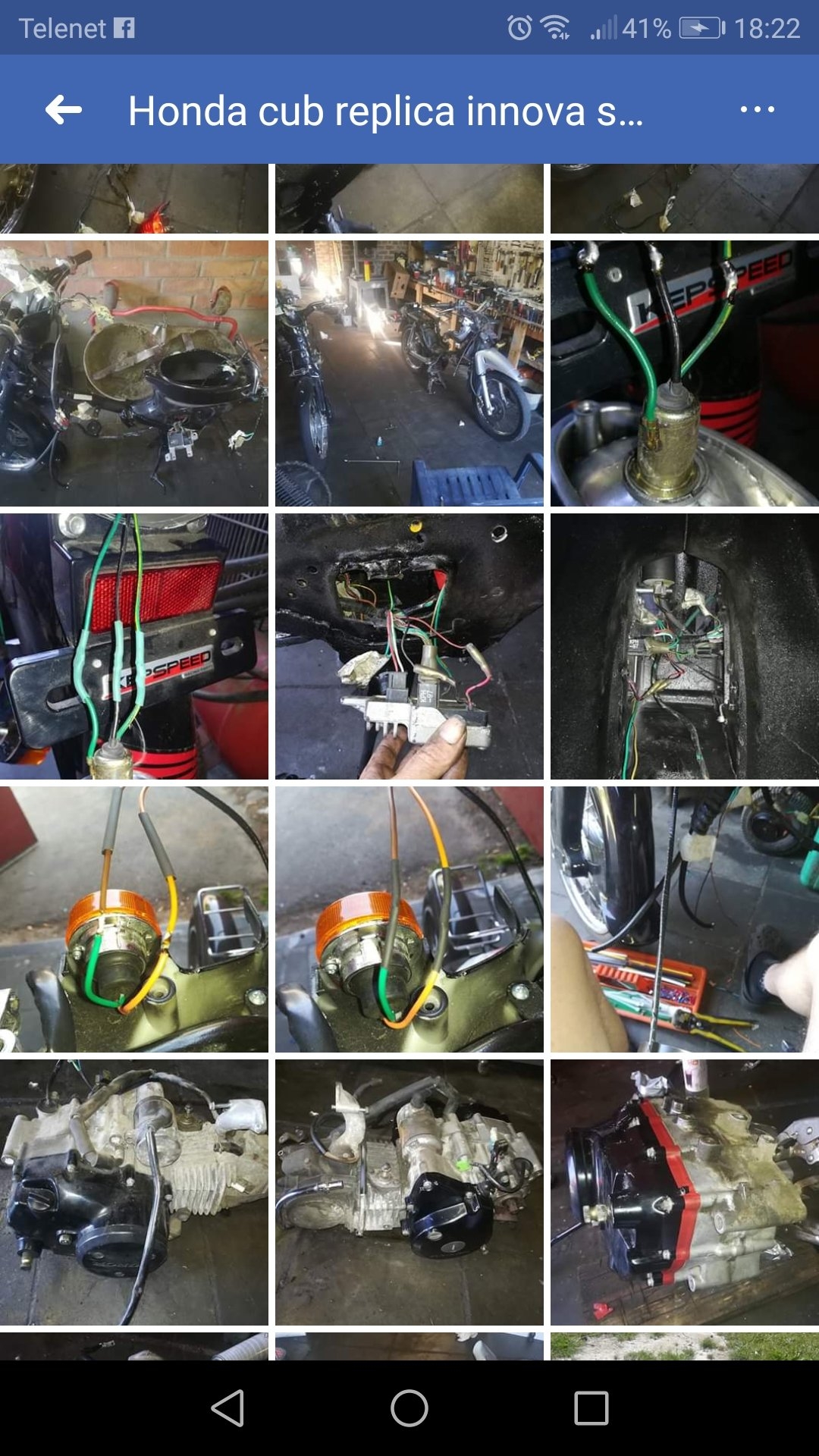

I had (or stil have :) 2 innova's, one is stil compleet, but the other is for parts.. Or better.. The other is used for the engine to fit in my cub..

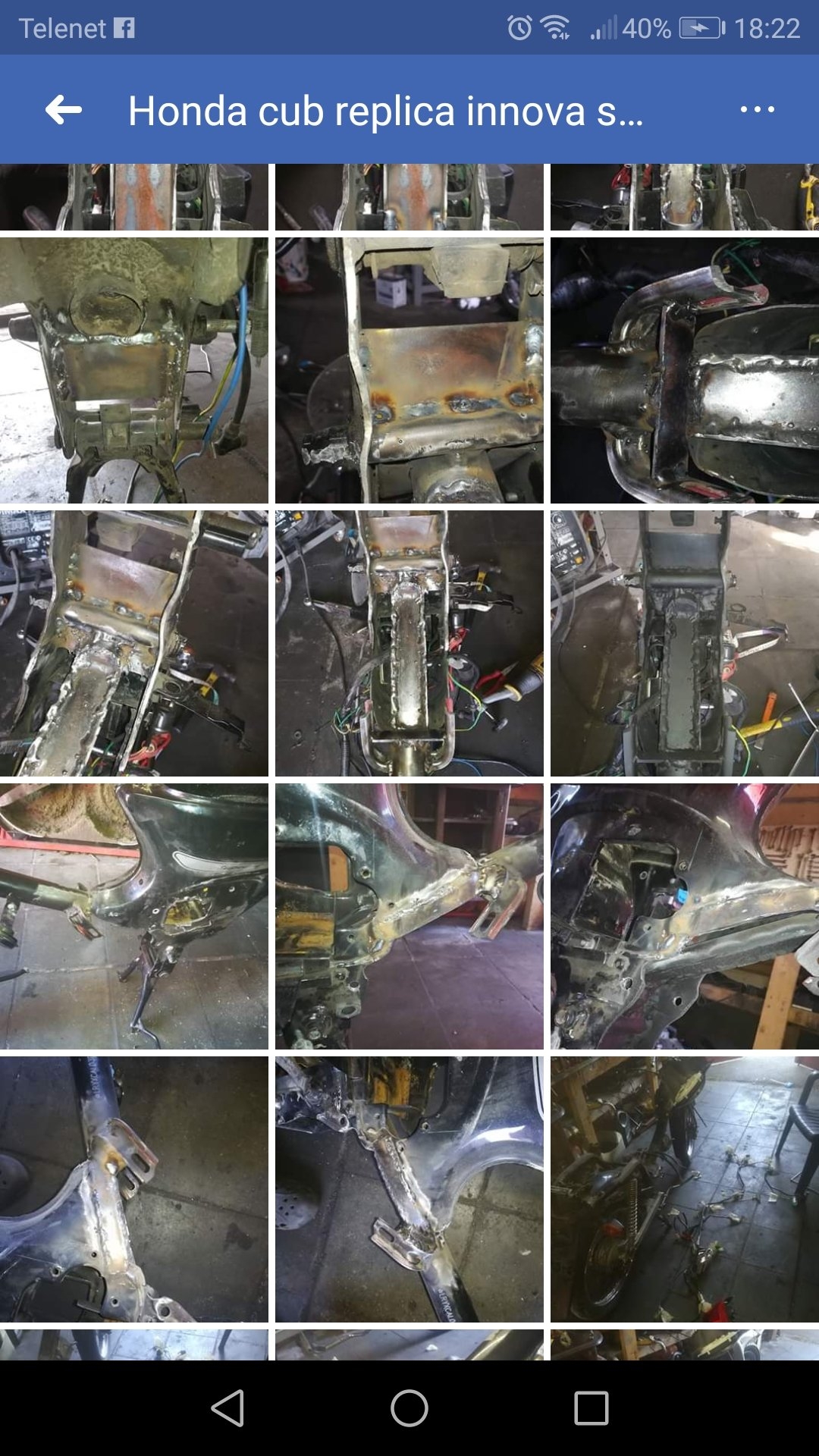

So i did the swap, wich was alot of work.. Welding.. New mountings, Electrical swap etc..

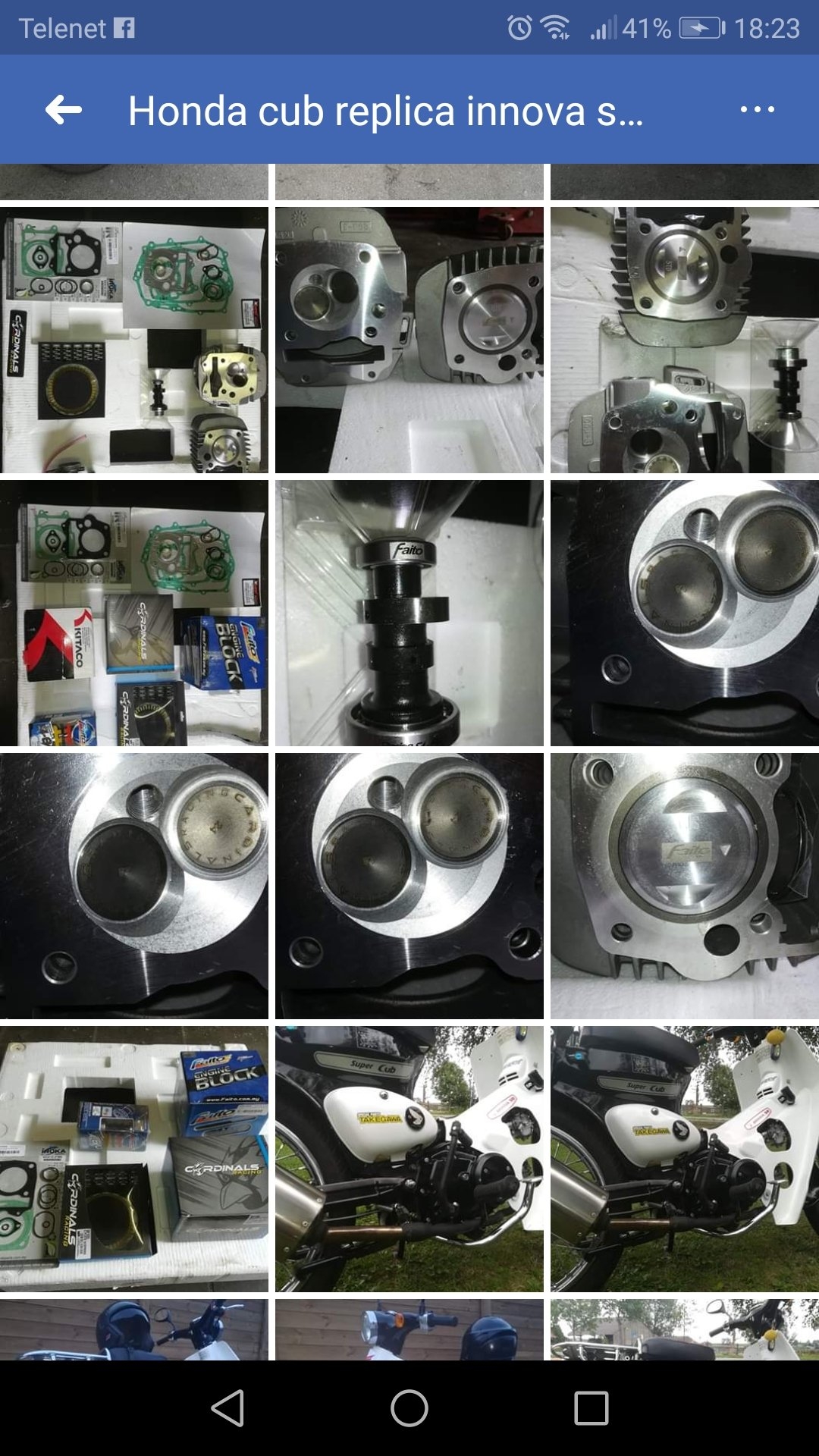

The engine himself is also upgraded, here is the partlist til now:
*Faito 57mm or 148cc high pressure kit
*faito s4 evo stage 2 cam
*kitaco valve springs
*cardinals racing big valve head (24/28)
*head ported
*cardinals racing clutch kit
*mikuni vm26 (28mm would be better so i gonna buy yoshimura yd28 later)
*daytona digital cdi
*takegawa oval silent muffer
*frame*
*honda brakes front+rear
*honda bearings front+rear
*kepspeed +2 aloy swingarm
*diy chain 428 + 428 gears (17/34)
*takegawa rear springs
*12v gps plug

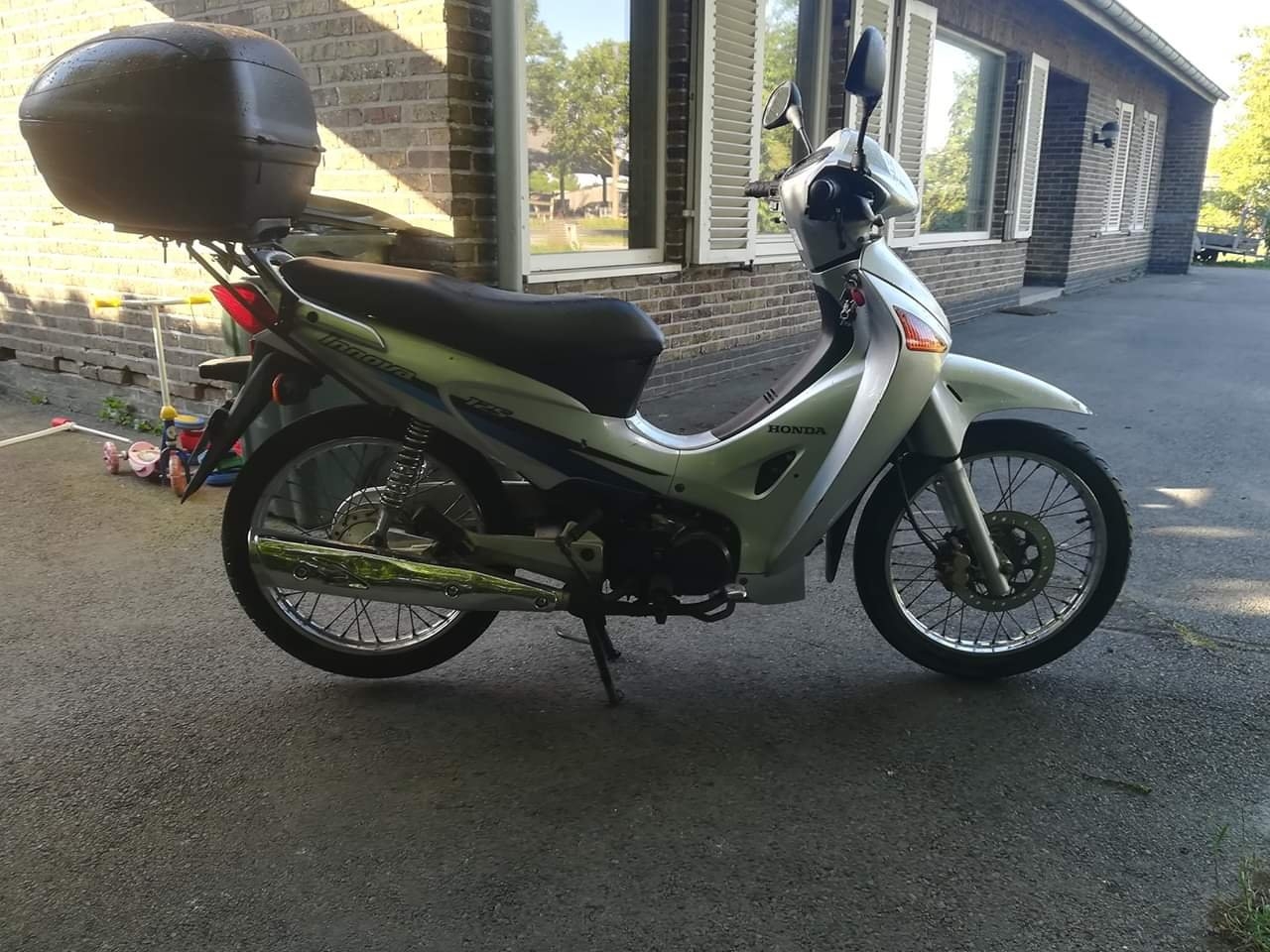

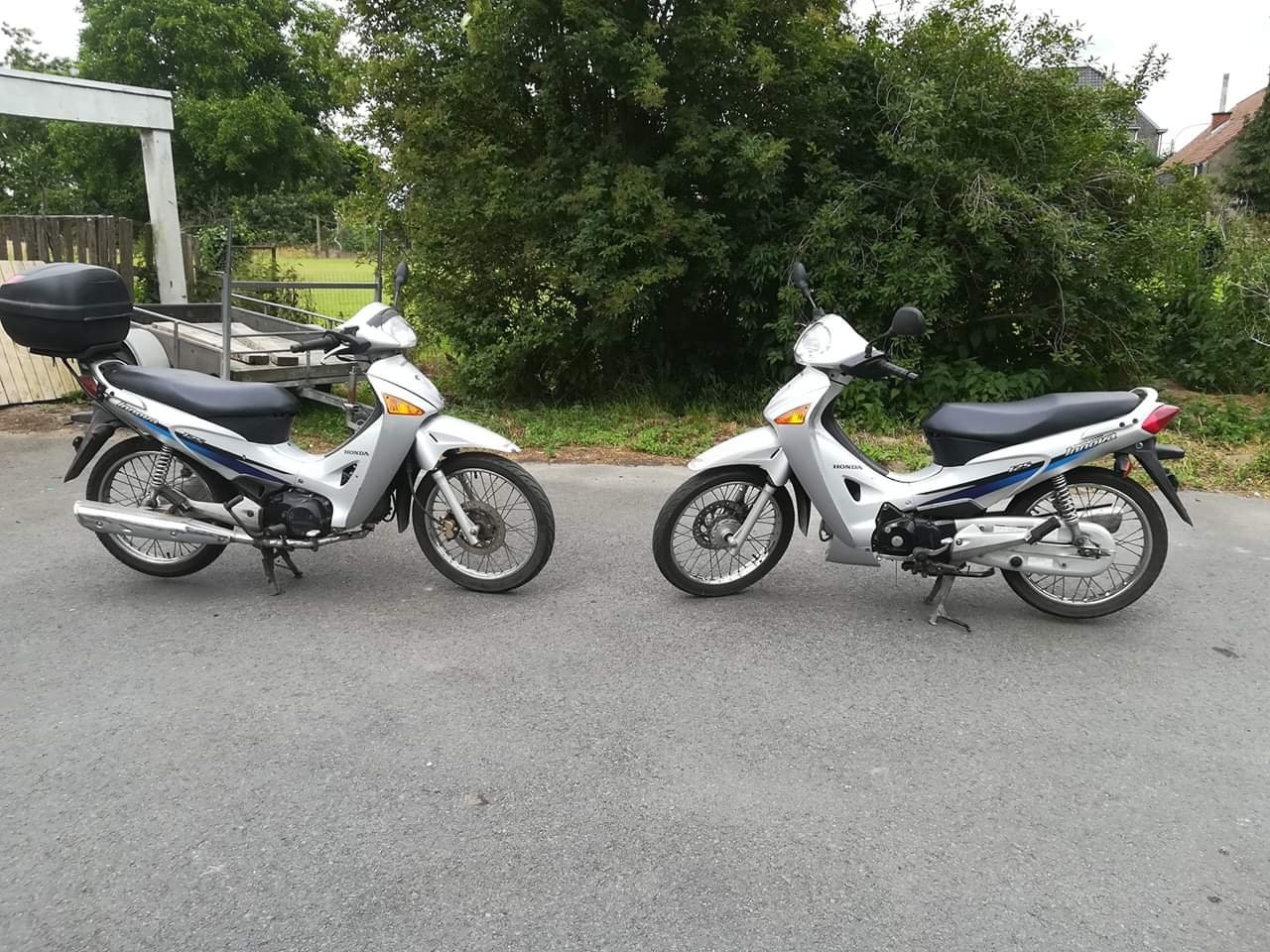

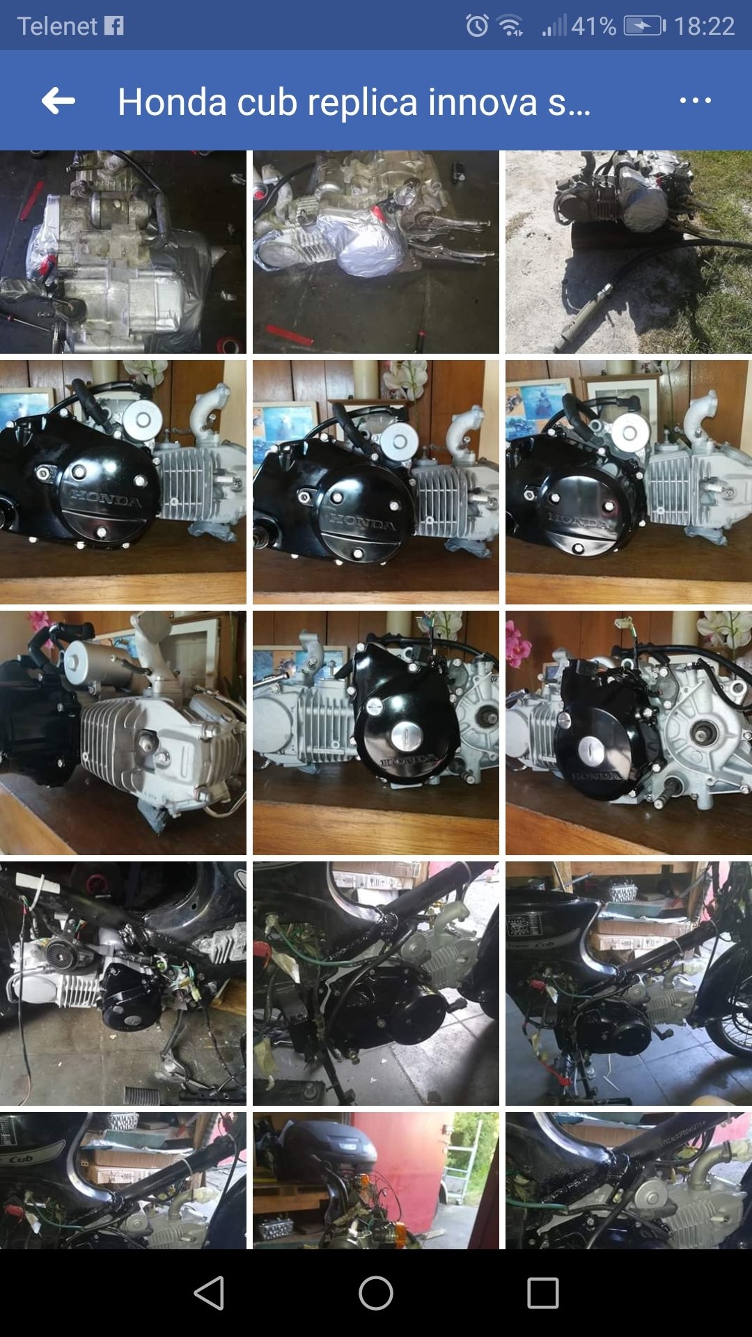

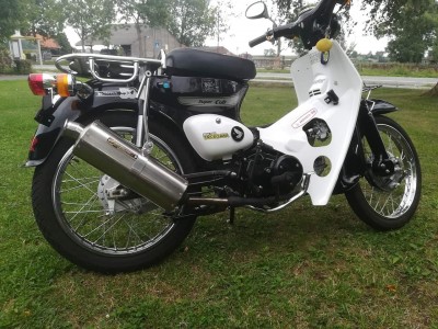

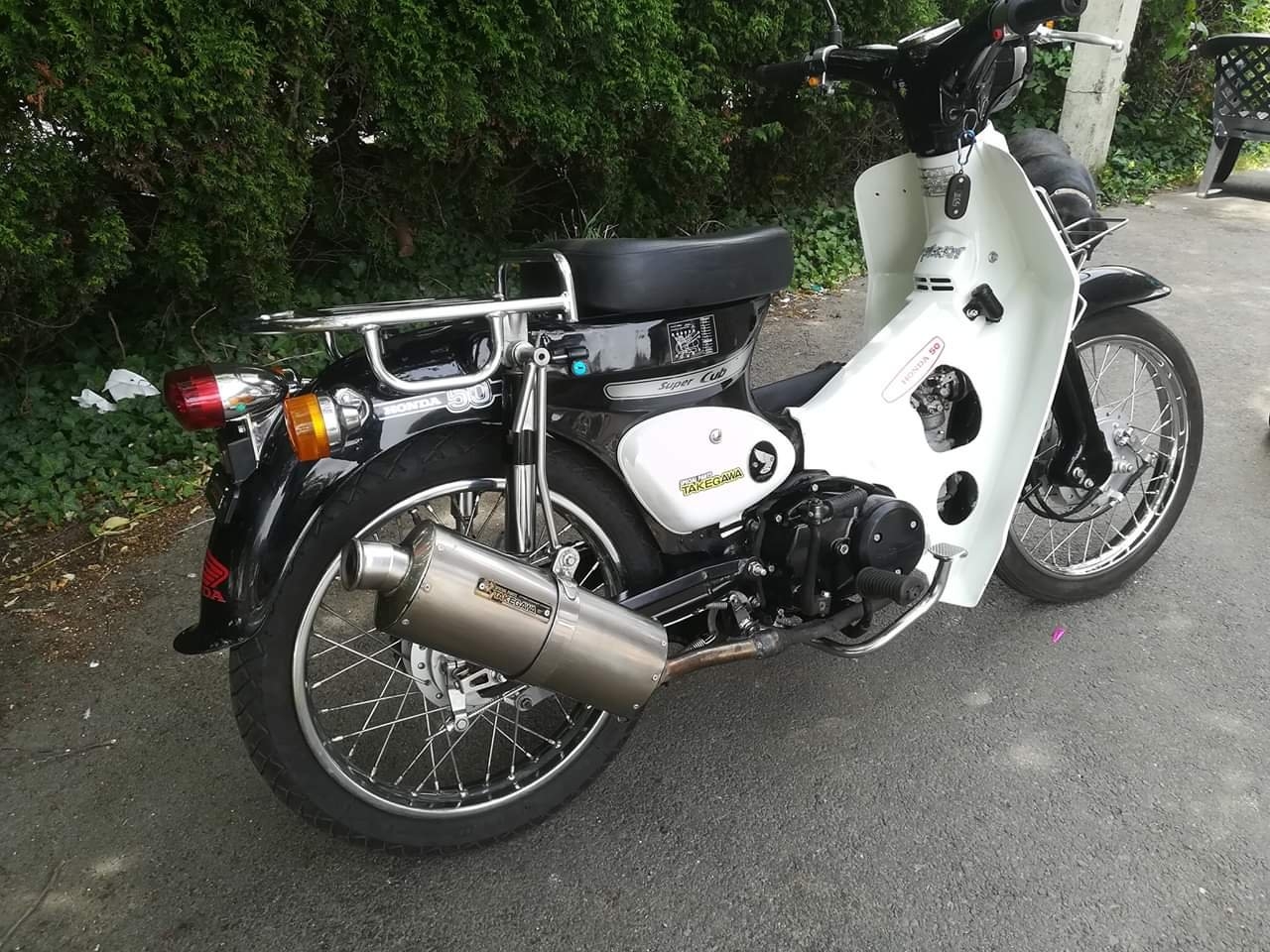

Here some pictures off my 2 innovas (now one :oops:)
And some Quick pictures of the swap 🙃

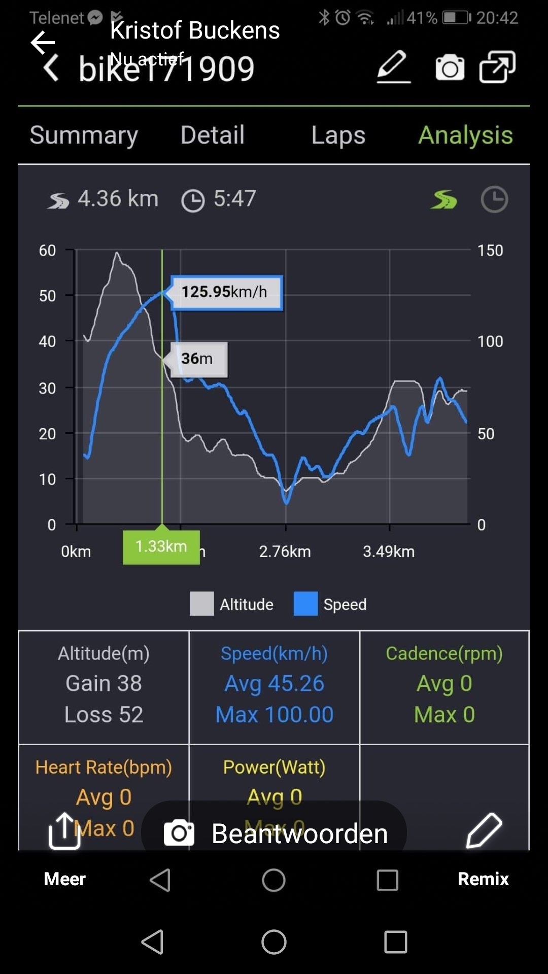

I think you dont now a innova engine good anough 😛 this engine's can handle whit the stock internals 200cc.. Maximum is about 245cc but then you are better put a stronger crank in it..
The injection models can run whit a takegawa ficon-2, i am busy now whit this on my brother's innova. But I prefer the carburator models.. Much easier..
I run now a while the 148cc kit wich i post in my begin post.. Thats run great, i had before a daytona 150cc but this one is by far faster.. Also it like's high rpm's, its become a compleet other engine than stock. When the yoshimura yd28 is on it i gonna do a dayno run to see what it got 🙃

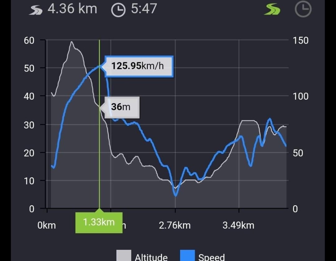

picture is the topspeed now 125.9 km/h on gps or a litle 80mph.. I expect to go further than 130km/h when the yoshimura yd28 is installed and when i got the adjustabel cam gear, the timing is not really on time now, i think i lost some hp there..
